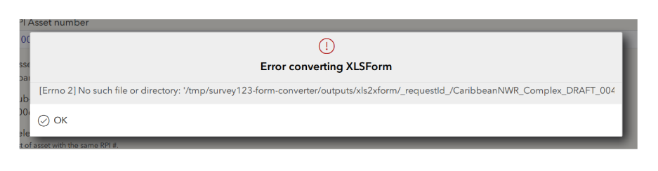

Hello Community,
I am having a big problem with Survey123 connect and I was wondering if everyone is having the same problem. I can create a survey with no problem, but it won't update any changes on the XLSForm. I keep getting "Error converting XLSForm" (see pic).  It won't reflect  any of the changes even if I close the app and open the form again. I noticed that if I continue clicking on "update" icon ( 10+times) it would eventually work . Does anyone having the same issue or my app files are is corrupted (I already installed the app 2 times? - 3.14.281)?

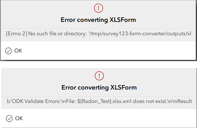

abureaux
MVP Frequent Contributor
Finally remembered to catch the error messages.  Here are the two I am getting. I just keep refreshing the app and the errors eventually go away. Sometimes it's 1 refresh. Sometimes its 5... The errors (image below) can also rotate between each other.
Connect also likes to freeze and crash a lot since these errors started happening. It is in no way related to a specific survey or operation. All seems very random.
