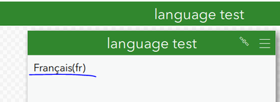

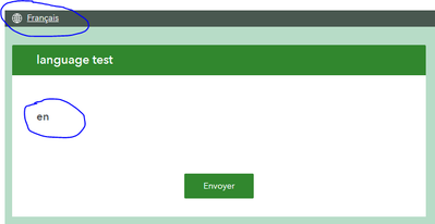

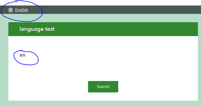

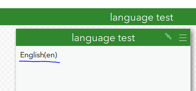

Multiple language Survey123 form with Standard Template,  try to use pulldata("@property", 'language')  to get current language, for field app it works well,  but for web app it always return "en".

This is a known software defect currently logged as BUG-000137706 BUG-000137670 and scheduled for a fix with the 3.13 release on September 16. See the Fixes section at: https://community.esri.com/t5/arcgis-survey123-blog/what-s-coming-in-arcgis-survey123-september-2021...   Please note that for the fix to take effect, you will need to install Survey123 Connect 3.13 and republish your survey or disable version locking.
