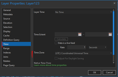

In ArcGIS Pro, when you add the service to a map, you can check the layer's time zone setting in Layer Properties > Time tab.
I would assume the S123 app will look at your device's timezone setting and adjust accordingly from the feature service's timezone setting. When you view it in ArcGIS Pro, the data comes in as UTC+0 and will need to be either mentally calculated or rehandled by a pop-up. On ArcGIS Online, the date is converted according to your computer's time. For working with dates in ArcGIS Online, see this article.

I adjusted my timezone settings in the service definition and in ArcGIS Pro, but was still seeing issues in the downloaded data. I eventually realized I needed to update my ArcGIS Pro to the latest version and this then automatically adjusted all my time values to the proper timezone.
