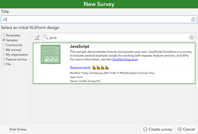

I'm not sure I fully understand your question but 'pulldata(@geopoint)' is only going to retrieve the available data stored in your point (eg x/y/z co-ords, horizontal accuracy etc etc). If you would like to retrieve data (from an existing polygon feature layer) and populate this into your survey based on your geopoint location, this requires a JavaScript function.
Please take a look at the 'Working with a Feature Service' section of the 'JavaScript' sample (available in Survey123 Connect) for an example of how to set this up. It can be adapted to use your own feature layers.
