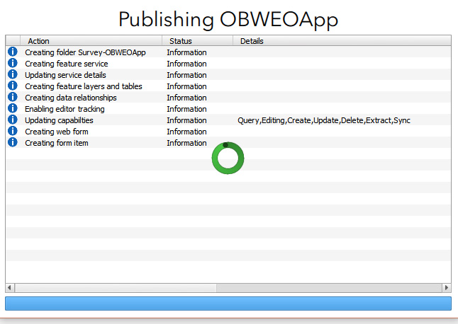

I am trying to publish a survey with a .tpk basemap to our portal. For some reason, it continuously hangs on creating form item and never finishes publishing the survey. This is a copy of a survey I have published before (but had to delete), so I do not know what the problem is.
There are currently no either items in the portal (all content has been cleared).
Screen Capture

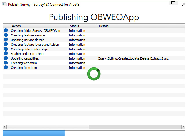

The screenshot below was taken about an hour of the one above. This is where it has been spinning and spinning.
Screen Capture2

This indicates that an error occurred during the form upload process that was not caught by Survey123 Connect.  There are a few conditions that we are aware of that can cause this, such as a form with a large number of images in the media folder (above 1000).  If possible, could you delete the folder Survey123 Connect created in your ArcGIS account, re-open Survey123 Connect, enable logging (see Troubleshoot—Survey123 for ArcGIS | ArcGIS; turning on logging without selecting a console will save the log to a text file) and republish?
ToddFagin
Thank you for your reply. The only thing in the Media folder was the tile cache (single .tpk file--about 780 mb). I removed it and was able to successfully publish the survey. I then manually added the .tpk to the appropriate folder on the device.
