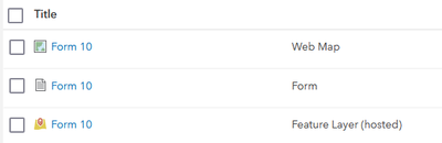

Odd. I always get all three layers, irrespective of survey contents. (Enterprise)
For example, this only has one question:
If I ever saw anything less than this I'd consider it a mis-publish, and delete and try again.
