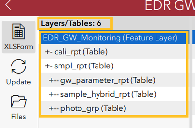

I have been troubleshooting an issue with the Survey123 website not loading a selected entry properly in the panel that pops up to show the details in the form view, it just spins endlessly. Through this we have noticed that the surveys that seem to have the issue all have an additional table in the results view.
Main Layer:
Results View:
Has anyone else encountered this? Any ideas what causes this?
I'm trying to figure out how this would have happened and I can't come up with anything unusual that I would have done, I simply share the results from the Collaborate tab on the Survey123 website, and it creates the results view automatically.
This explains why I had issues updating the view from the Settings tab in the item details for the view as well (the questions were all mismatched for the respective tables) though I feel that Survey123 publishing should do this automatically too.

That's a good point, it is odd that it is 0 and 1 like that, though I wonder if it's because it's the primary feature layer and then the rest are related tables, it would always be put as the higher number?
When I try the update view, it shows me the 4 expected tables, but the fields are like:
Mowing Work Orders (0) --> Mowing Work Orders (0)
assetRepeat (1) --> Mowing Work Orders (1)
employee_repeat (2) --> assetRepeat (2)
vehicle_repeat (3) --> employee_repeat (3)
So the fields don't line up, I have no idea what it will do if I try to proceed with updating the view, I'm worried to try when it's live data lol.
