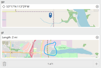

I would like to see the first geotrace visible in each one of the maps I have in the repeats.
I'm not sure I understand the question. When you take a point/trace, they should be visible in the app:
Or do you want these visible in the Feature Layer? In which case, yes, you need to submit first.
