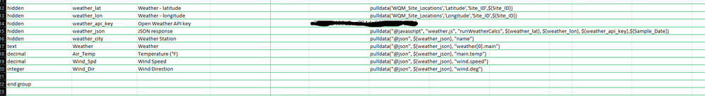

I am make a form that I would like to call historical weather information when the user picks a date. I was able to get a general JSON response but am having trouble calling individual fields like precipitation. I am using Open Weather One Call API 3.0. Attached is the test xls form and js file for reference.

DanLissick
Hey @ZacharySutherby
I do have that function in the attached documents. What I am looking for help on is a specific formatting pulldata("@json"). Here is an example: pulldata("@json", ${weather_json}, "weather[0].main"). Using the Open Weather One Call API 3.0 - Historical Weather do you know how "weather[0].main" should be formatted? I can get Row 13 to run but now row 14 in the attached .xlsx. I have also attach the.js file.

I know it's been a while since OP, but I've gotten this to work for the non-historical dataset (e.g. v2.5):
I'm now attempting to use the historical One Call to get weather for past surveys and am not able to get the fields to populate after selecting a date. Thinking it has something to do with the fact that maybe the API call fires off as soon as the survey opens and thus the date field is blank?

I was not able to get this to work. I believe you would need to pay for the Open Weather api instead of using the free version. If you ever find a solution I would I would appreciate a response to this post.
