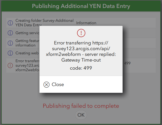

I'm trying to publish a survey that was created from an existing feature service.  I keep getting an error stating Error transferring Gateway Time-out code: 499.
I'm not sure what I have done wrong for this to not work.  I tried publishing other "test" surveys and they all published successfully.

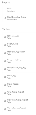

The image below illustrates how I setup my feature service and related table connections.

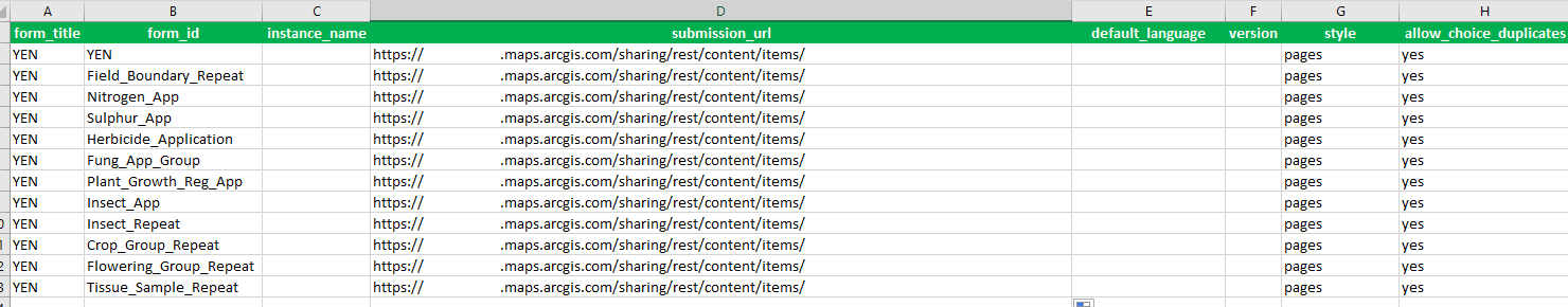

There should only be 1 submission URL.  At least I have never seen it done any other way.  Then the names of the repeats and the tables in the service should match up.  That is how it all connects.

I'm not entirely sure that I am doing the submission URLs properly.  I originally had just the one submission URL but when I accessed the Inbox, my related records were not showing up at all.  Doing it this way ensured that I saw all my related record data.

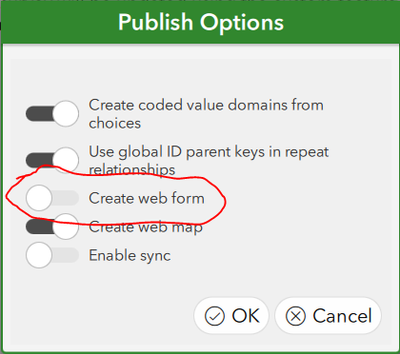

As far as the error goes, I believe my issue was that I had some Choice Lists that were ridiculously long.  I believe these long Choice Lists were to much when creating the Web Forms.  Because I want my user to only use the Field App, I turned off the need to create a web form.
Once I turned of the web form, my survey was able to publish with no more errors.  If you have large Choice lists I would suggest looking at using External Selects.  https://doc.arcgis.com/en/survey123/desktop/create-surveys/xlsformcascadingselects.htm

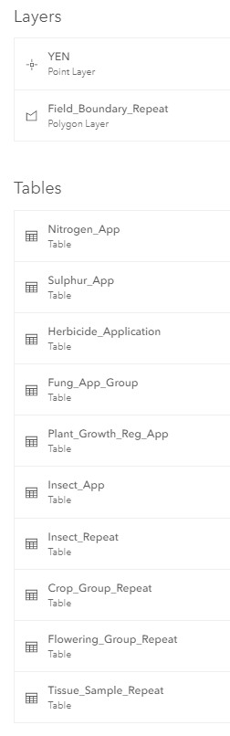

Are your related records in the same service and have the same table name as whatever you called the repeat?  That is how it all lines up.
DanBihari
Yes, all those related tables are in the same Feature Service and all the repeat questions use the same table names.

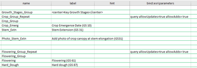

And you have query allowUpdates=true in the bind::esri:parameters column of the repeat?  And then enable Inbox is on the form?
Did you just remove the item id for display in your image?  Should look like
https://www.arcgis.com/sharing/rest/content/items/34859fe3b9d14879ab815dc7ea4444
Do the names of your begin repeats match the table names in the service?

Yes I do.  Here's an example of a couple of my repeats.  They all have them.
That's correct, I stripped out the service URL.
