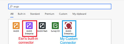

I am also Enterprise. There are two ways to get Power Automate to work wither Enterprise now, actually. 1) a custom connector, and 2) Esri's Built-in Connector. The second way is new, and very easy.

It goes into detail not just on generating a report, but also a few best-practices. It uses the "not quite the old method, but now not quite the newest method". Aka, it uses a Custom Connector for listening and generating a report.
In Power Automate, search for "arcgis" and you will see Esri's options. Just choose the ArcGIS Enterprise option, and then the "When a survey response is submitted" option
