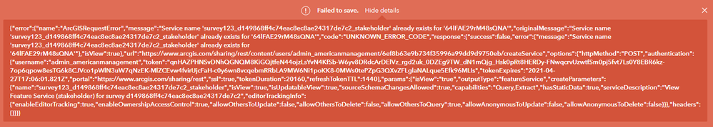

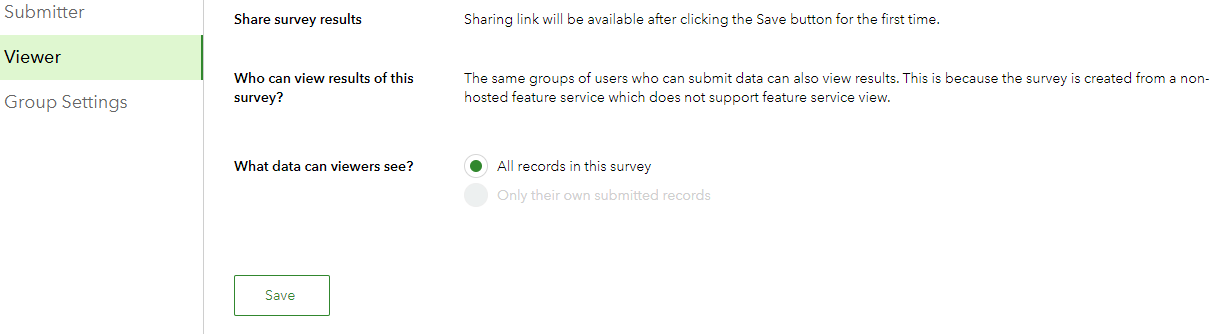

I have a survey that I published using Survey123 Connect for ArcGIS 3.6. This survey is using already existing feature service that was published earlier using ArcMap. Users are able to submit their answers and everything works fine, but when I try to click 'Save' on this window:
I am getting this error message:

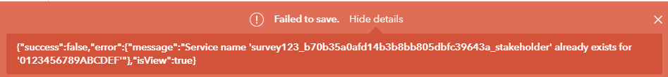

After, hitting a 'Save' button second time I am presented with this error message:

Thank you for your reply. Unfortunately, I do not have an option to create a feature layer view. I only have these options:

LJackson29
I think I figured out the issue. The first time, I tried to update the Sharing Results to a group, there must have been a blip in the system, and it created an empty view. When I tried Sharing Results again, it did not like that a view already existed. I deleted the view, and was able to update Sharing Results.
