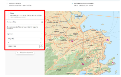

SMH-Rio
In my workflows, I only need users to not edit already submitted repetitions when they open the record in the Web App (there is no other relationship with form fields - I just need to simulate the 'allowUpdates=false' from the Field App).
In this case, I do the filter directly in the layer that receives the responses from Survey123 (I don't do anything in xlsxform). I used the globalId as an example (because I can publish surveys with the global and parent), but in reality, it could be any other column in the database: the condition just needs to never be met. In other cases, I've done 'objectid = 589237598723598327', for example. The trick is that the condition is not met, regardless of the column used in the filter.
I hope this helps you.
