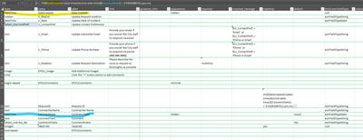

Aha yes, well that got past the error, but unfortunately it did result in a change in the form behavior. I also tested out stripping the repeat date out and just replacing it with now:
if(${DateCreated}>(now() + 0.0104166675),'yes','no')
but that didn't make a difference either. I was following Ismael's blog about using dateTime comparison/calculation which is how I arrived at the + 0.0104 etc number as a test. So I figured I'd also get rid of that time add and just try it against now(). So here's my test form with three different readonly contingencies:
And all of those fields remain editable
