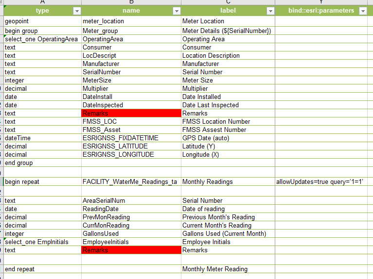

So after two straight days of figuring out how to build my form that contains water meter points with a related table of meter readings, I have almost completed the form the way I want.
However, I don't understand how to order my existing repeats by descending from my date field.
This is what I have so far (which works):
However, if I try to add (with a space), orderBy=${ReadingDate} after query-'1=1', the form fails to download the repeats.
Can someone please help me with what I need to put in? In the form, I would like the repeats to show the latest to oldest records, as you tap the forward arrow button.
Thank you,
BrandonArmstrong
Hi Anna,
The orderBy parameter is not currently working for editing repeats in the inbox.   We do have an open issue related to it in our backlog, and we will be looking to address it in an upcoming release.
