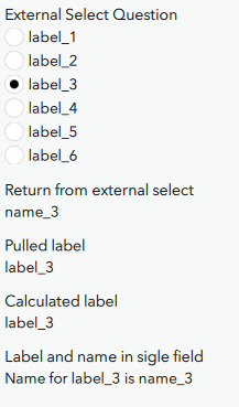

There's two ways of calculating the label in a new field. You can either pull the label from the csv or use jr:choice-name to calculate it from the selected answer.
Example attached below
