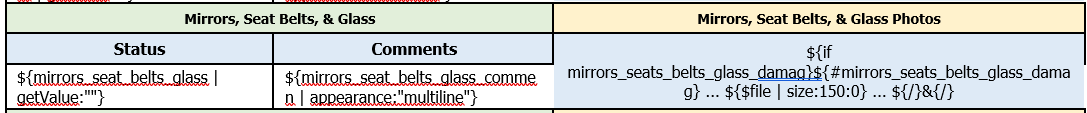

In the form, this is what the user has put in:
Mirrors, Seat Belts, & Glass
Mirrors, Seat Belts, & Glass Photos
Status
Comments
${if mirrors_seats_belts_glass_damag}${#mirrors_seats_belts_glass_damag} ... ${$file | size:150:0} ... ${/}&{/}
${mirrors_seat_belts_glass | getValue:""}
${mirrors_seat_belts_glass_commen | appearance:"multiline"}

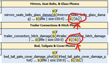

Here is a screenshot of the actual form:

After checking this out, I found this here, it may be the culprit, once replaced, if still not working I was curious if you could share your xls form as well?
I found this here:
Notice how the mirrors_seats_belts_glass_damag section does not have a $ on the final {/}, it has an ampersand instead, I was curious if changing that would be beneficial?
Hope that helps!

I was curious if you could attach the document that these are in? I've seen some issues with formatting appearing as set and looking clear, but as soon as you go to start digging in, there's a space or an issue somewhere. I'm interested to see what "}$repeatEn" could be as well!
Cody
I found this here:
Hope that helps!
