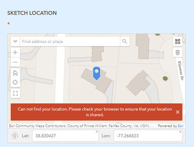

Even by typing a coordinate on the default collum, for the geopoint field on the .xlsx form, (such as "48.858328 2.294513") , I get the message on the survey with no point selected:
- Can not find your location. Please check your browser to ensure that your location is shared
On top of that, there point And if I allow the location, then it points to my house.

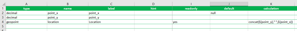

I tried this out. If you set the default value of the geopoint question to null and you pass the center parameter, the geopoint value will keep your coordinates. I think this is the simplest approach, and the closest to what you already had.
In my case, trying to set the value of the geopoint question directly using field:<nameofgeopointquestion> did not work.
Alternatively, you can also go with the XLSFom below and pass the point_x an point_y coordinates using field:point_x
You may want to set the appearance in point_x and point_y to hidden so the questions are not visible. In practice, unless you want to store the X Y coordinates as attributes, I think the best is to just use the center parameter.

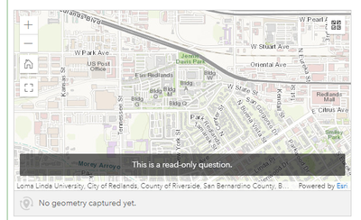

I already tried it yesterday. It does not fix the issue, and also adds the problem that if someone clicks on the map, it updates the point to their current location (even if the question is set to read only).

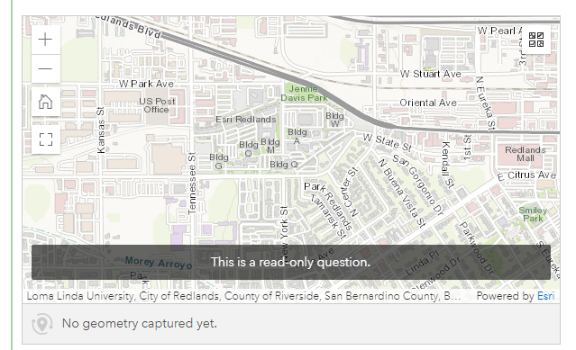

Thanks for the answer. The null value works, it stopped asking for my location. But not it gives a blank value, not centering on the XY, but instead the map points at LA (which is the default value for blank geopoints?)

Thanks for your answer! That calculation you suggested works, even after removing the center on URL. I am not sure what I was doing wrong before, but I tried it in the past without success. Yes the XY were hidden, this was just a dummy survey to test things. And thanks a lot for all your posts regarding Survey 123, I do use them a lot.
