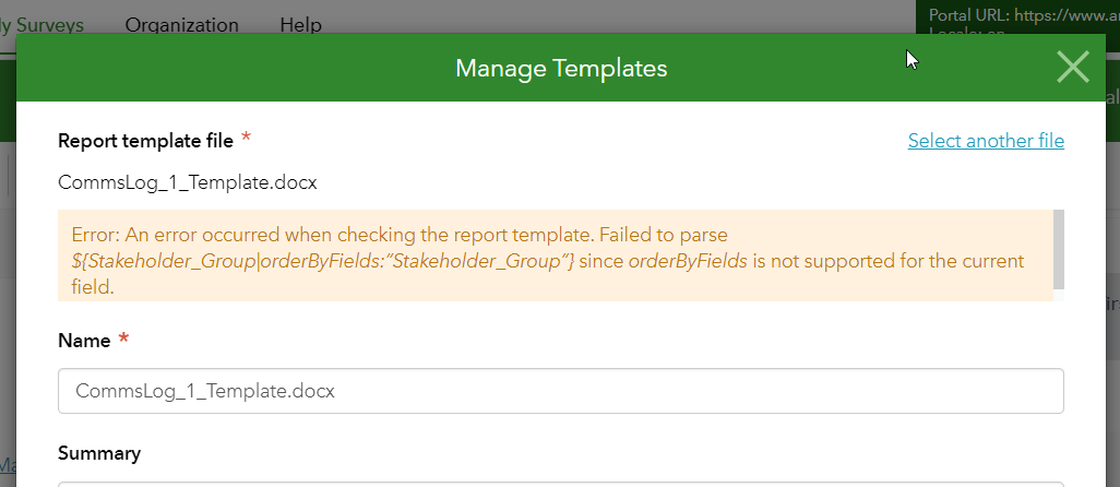

Hi there,
I'd like to set up a summary report ordered by date_created and then by stakeholder_group (text field).
I read the report documentation, but it looks like DESC only works for some field types? Or only for repeats? The data I'm working with are not repeats. Which ones? I got this error when I tried putting it into a non-numeric field. Have I interpreted the documentation incorrectly?
So is there a way to order fields first by the date_created field, and then further by stakeholder_group(alphabetically).

Hi @elpinguino,
Yes, it is possible to apply an orderByFields filter based on one or more non-numeric fields. The filter can be applied to a repeat in an individual report or to the survey layer name (using the repeat syntax) in a summary section.
The syntax for that would look like this: ${#layer_name | orderByFields:"field1 DESC, field2 ASC"}
I attached an XLSForm, report template, and a report export that show an example of ordering a summary section by date and then by stakeholder. Hopefully that will help with your report template.
