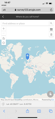

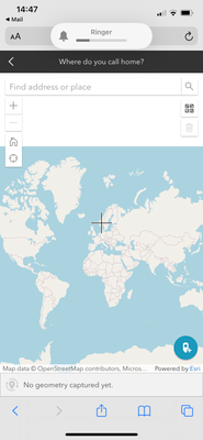

Sorry, you're right @kurdishbrwar , here are some images to demonstrate!
Step 1. click the map
Step 2. Go to location within the map (map is at full screen)
Step 3: click the map pin button on the bottom right of the map, to drop a pin
Step 4: click the black question heading at the top of the map to return to previous screen.
Step 5: Click 'submit' button to submit the questionnaire.
Is there any way to prevent the map from becoming full-screen?  It's the step where users have to click on the question heading to go back to the actual question that seems counter-intuitive to me.  Am I missing something obvious?!

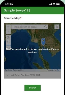

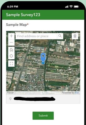

Please try setting the Map question to prompt for a user's location by default and setting the question as a required question.
This should make the user be able to place a geopoint based on their current location on a map without having to open the map. (I tried tapping on the minimap and the location is recorded without having to expand the map. (SEE BELOW)

I have tested a similar workflow with a web form in Survey123 Connect with the following settings (Setting both the required and readonly columns in the XLSform to yesto achieve the same results.
typenamelabelrequiredreadonly
geopointlocationLocationyesyes
However, since your use case requires the user to manually add location pins on a map manually, this is more likely  another story. I believe posting this functionality request in ArcGIS Survey123 Ideas could be the best course of action, where the community can "kudo" or "up vote" your idea as popular ideas tend to be considered by the Product Team.
I concur that the map expanding on mobile could be expected behavior as it could be difficult to provide a pin when the map is small. Please provide the explanations in your Idea post regarding the use case/workflow/number of clicks required etc.
