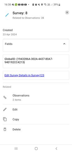

I've found a workaround by setting up two Survey123 forms with Inbox's, one for editing the survey layer and one for editing the related records layer. Then have separate hyperlinks to each one in Field maps. It would be nice to do it all in one, but may have to leave it in the interest of time
Screenshot_20240502_164437_Field Maps.jpgScreenshot_20240502_163831_Field Maps.jpg
I take your point about preferring Field maps too. It works out really well for my situation being able to view the results on Field maps, both lines and polygons together, then editing through Survey123.
