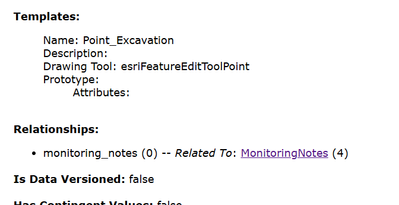

Here's the break down on the Feature Set by Relationship Name function:
FeatureSet functions | ArcGIS Arcade | Esri Developer
'monitoring_notes' in mine is the relationship name between my point layer (parent) and the monitoring notes table (child) as set by the hosted feature service.  To find it, open your hosted feature service, click the link to view the REST services, then click on the parent layer. Scroll through the REST data until you see Relationships.
point_guid is the GUID field name I set in the child layer, yours will need to be whatever your GUID field name is. The False parameter is True/False for bringing the geometry in with it.
