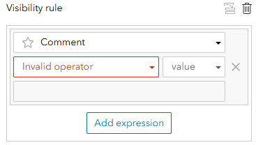

Does anyone know of any changes that have been made to visibility rules for questions linked to a rating type question?
I have a well used survey that had several "rating" type questions that each brought up a field to add comments and a field to upload a photo for any entries of 3 or less.

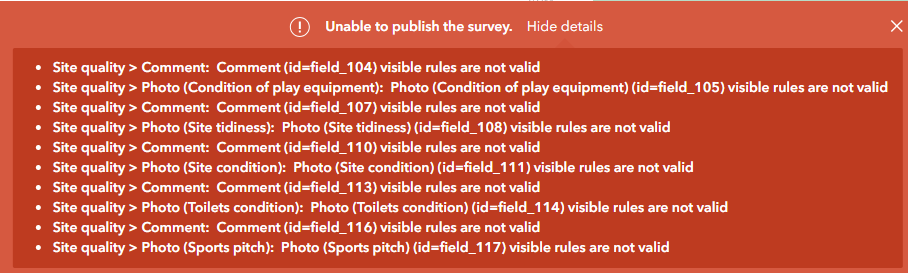

Today I noticed I am unable to republish the survey as it brings up an error message and says the visible rules are not valid.
No matter what I set the visible rule to, it keeps saying it is an invalid operator.
Has something changed so that you can no longer apply visibility rules to rating type questions?
Thanks,
Steven

Sorry, my misunderstanding. I deleted the rules and was able to save and publish the survey fine. However, when I added the rules back in and tried to republish, I was hit with the same "invalid operator" issue as before.
I've not used Connect before as I couldn't get my head around it so I might contact Esri direct as it could be a software bug
