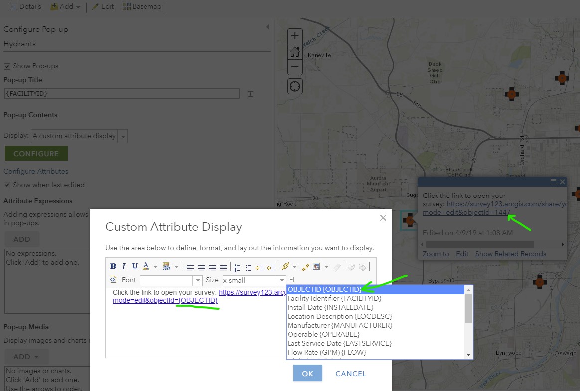

If you mean the popup in a web map, you can configure the popup in Map Viewer by using the pattern {fieldname} to insert a field value dynamically in the popup. I found a clue in the doc Integrate with other apps—Survey123 for ArcGIS | Documentation and tried the settings in the attached image below. Would you mind having a try to see if this is what you want?
