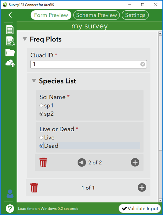

Here's the survey form. The first record, Quad ID 1, has 2 inner repeat records, sp1-live and sp2-dead hence why you see the 2 of 2 count on the inner-repeat. This is the behavior one would expect.

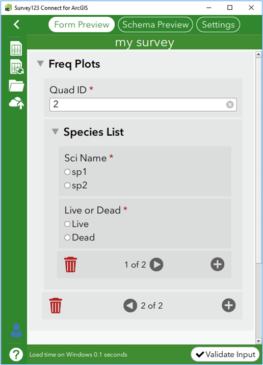

This is Quad ID: 2, the 2nd record. Here's a screenshot immediately after entering the Quad ID value. Notice how the inner-repeat is already pre-populated with 2 blank records. If the previous record, (Quad ID: 1) would of had 3 inner-repeat records, then this record would of also had 3 blank inner-repeat records and so forth. The biggest issue is when you arrow < to previous outer repeat records then try to navigate through the inner repeat records. You get validation errors because the blanks are not meeting the field required.
