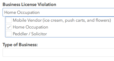

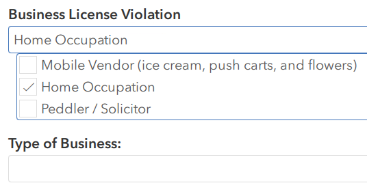

Hello, I created a survey using Survey123Connect and need some help with the Select Multiple type.

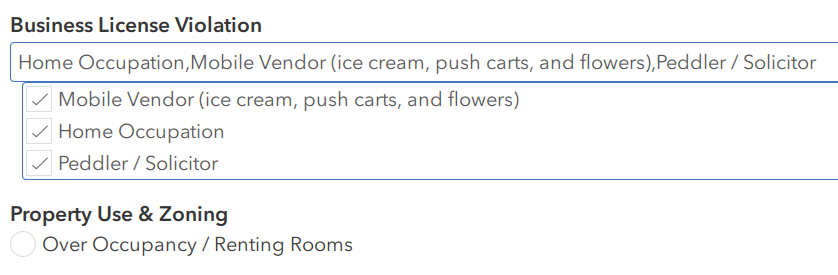

The survey contains three multiple choice lists. If a user selects a specific choice, a question will appear below. The issue I am running into is that if multiple choices are selected and the "specific" choice is in that selection the question does not appear.
This is one example:
When a user selects "Home Occupation" a text box appears that allows them to type in the "Type of Business". I have the relevant set to ${business_license_violation}='Home_Occupation'
 But the text box does not appear when multiple selections are made.

Try this for your relevant statement instead: selected(${business_license_violation},'Home_Occupation')
Essentially, with select multiple your choices are combined into a comma delimited list. So selecting all three options would produce: 'Mobile_Vendor,Home_Occupation,Peddler'. So setting the relevancy statement so 'Home_Occupation' would evaluate to false. Using the select function gets around this behavior.
Hope this helps!
