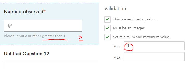

When adding a number question to my survey (using Survey123 website, not Connect) and setting a minimum value of '1' for validation, the automated error message says "Please input a number greater than 1".  This should really be "...greater than 0" or "...greater than or equal to 1" shouldn't it?
Jim-Moore
Hi @BryanWright, thanks for picking this up - the validation message should be modified as per your suggestions.
If you're able, could you please log this issue as a bug through Esri Support so we can attach a BUG number to it?
