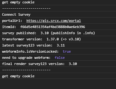

Based on the description, your second half operation is using the web form, correct? Can you provide details on the configuration of the form - what version was it published with, is version locking still on?
You are using ArcGIS Enterprise, correct?  Which version?  The error message looks to be one created by the feature service on submittal - can you check the ApplyEdits request being generated by the web form?
GaryBowles1
Second half is using webform from a dashboard.
Form was originally published using Connect 3.9.? It has been updated using Connect 3.10.?
Enterprise 10.7.1
Apply Edits
Thanks,
--gary

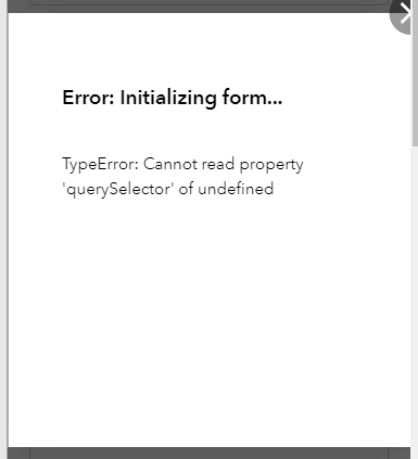

GaryBowles1
Hey James,
I upgraded Connect to 3.11, republished the survey and am now getting this error and cannot get the survey to load in ops dashboard:
Thanks,
--gary
JamesTedrick
Esri Esteemed Contributor
Hi Gary,
Is that when opening the form directly in a web page?
I'd suggest opening a formal support ticket - it appears there are potentially a couple of different issue occurring.
GaryBowles1
That was from an ops dashboard in chrome. I will open a ticket with support.
Thanks,
--gary
