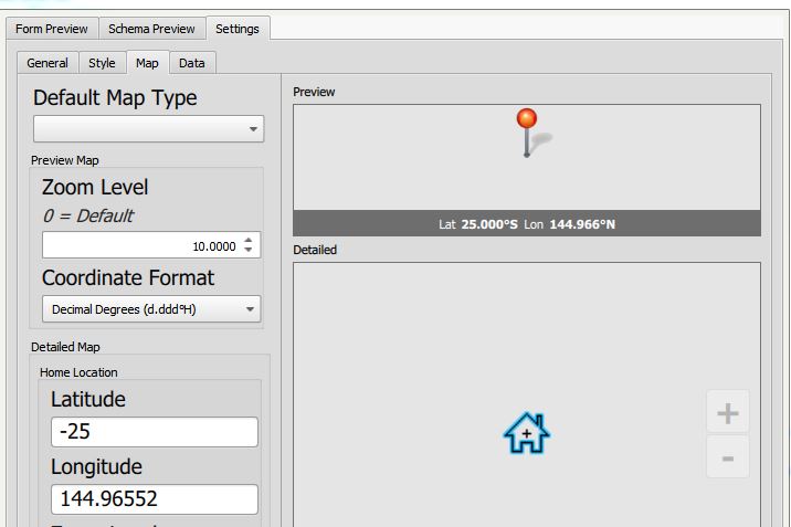

Looking at the Map Settings, the Default Map Type is disabled.  You can't change to anything.
We worked around the issue by taking the Excel sheet out and redoing the project.
We're on version 1.2.12 of Connect.  Though will upgrade to 1.2.18 today.
