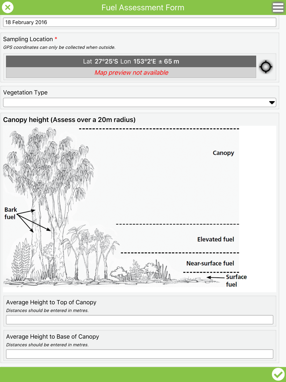

On version 1.2.49 I've just had the problem occur on a newly downloaded survey.
Same map downloaded on a iPhone6S with 1.2.49 doesn't display and also on an older iPad with 1.2.49 also didn't display.

I wonder if you get the Map Preview not Available when the device is offline.  The behavior of the app is to show that message when offline if your Survey has been configured against an online tiled service (which is the default configuration).
If you would like to configure your Survey to display a map while offline, you will first need to create a Map Tile Package in ArcGIS Desktop (ArcMap or ArcGIS Pro), then upload it to ArcGIS Online or your Portal, and then reference it from your Survey.  For details please see the Prepare basemaps for offline use blog post byMarika Vertzonis​  ,or have a look at this help topic: Prepare basemaps for offline use—Survey123 for ArcGIS (Beta) | ArcGIS
