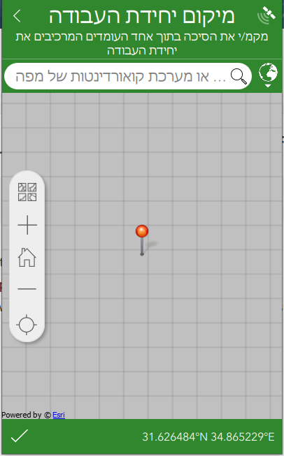

We are experiencing some issues with the webmap that linked to the survey.
Our survey linked to custom web map which is set as the default basemap.
Most of the times it doesn't show up when the user is trying to locate the spot of the survey. Instead it arrives as a grey background:
The map is shared only with authorized group of users, the same one that authorized to work with a survey it linked to.
Does anyone have any suggestions?

When I provided the map details I've been told that my map include tiled cache layer that is not shared publicly - this is a
known issue which prevent the map from loading in Survey123.
Hope it will be fixed soon.
