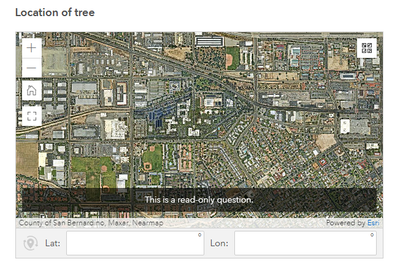

Thank you very much for this suggestion. It worked. I have one more query. On Survey 123, how can I add a pin to the location? I mean I need the blue point on the map for location as below. Currently its blank.
