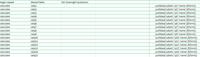

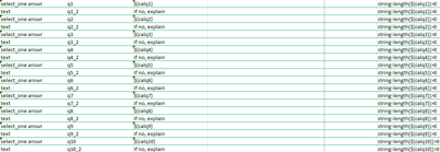

I'm having the same error though I don't have a geopoint in the survey nor are the attachments are causing the issue. I have a pulldata() function that pulling questions from a separate excel spreadsheet. If I don't fill in anything for that particular part, the survey goes through fine. I have two pictures for reference.
