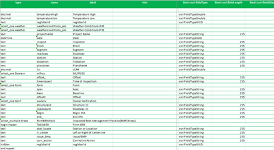

I am having an error appear when I am trying the submit/ edit a survey after it is publish the error message is as follows:
I've been look at this for hours and am not completely lost and dont know what to do. all fields show not errors and  Ive even made duplicates of the excel sheet to see if there was anything that popped up but to no avail. Any assistance would be greatly appreciated.

Just based off your screenshot, looks like you might have issues with the field names:
  • date
  • block
  • segment
  • begin
Just for the sake of troubleshooting, can you please give those fields a more unique name and publish a new survey from the XLSForm, and then test to see if survey submissions are successful?
  • date
  • block
  • segment
  • begin
mjennings323
That helped thank you
