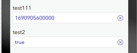

in survey123 connect (and android app) I get :

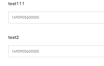

which is correct, but in the web app, I get:
where "test2" should also return "true".

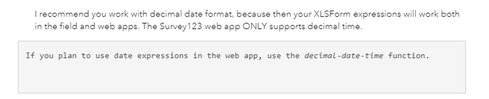

I ended up going back to the old Dates and Time in Survey123 and noticed this:
So I checked the documentation for decimal-date-time().
After plenty of trial and error, I got it working. I had to divide the calculations in multiple fields, for some reason doing it as a one liner didn't work (field3_tf).
