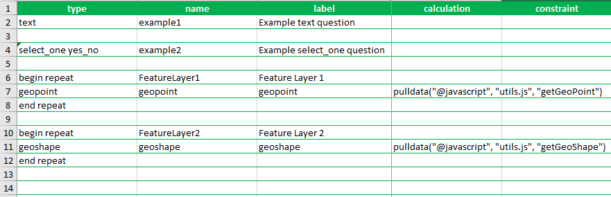

I would like to write JavaScript functions that can be directly used in the calculation column of geopoint and geoshape, as follows:
 * JavaScript functions for Survey123
function getGeoPoint() {
    // Add your code here
    return "1.0000 2.00000";
function getGeoShape() {
    return "0.0000 0.00000;0.1000 0.00000;0.1000 0.10000; 0.0000 0.10000";

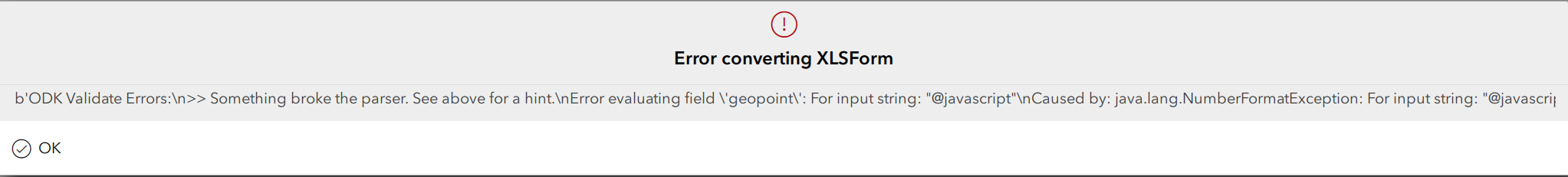

However, the above JavaScript functions do not work and return the following error:
It seems that the expected output is not some space-separated values of latitude and longitude.  What are the correct output from a JavaScript functions that can be directly used by geopoint and geoshape?  I can't find such documentations.
