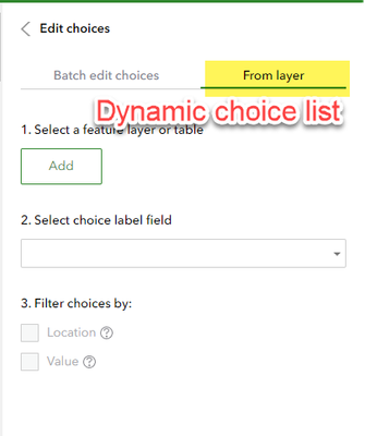

1. Is it a autocomplete question or a dynamic choice list (pull choice from a layer)?

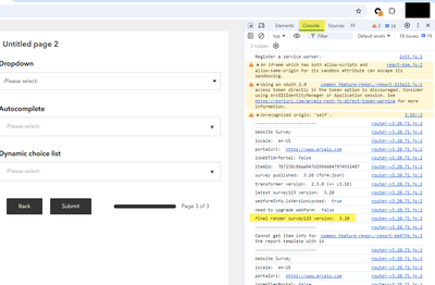

3. What version of survey are you using? (Press F12 to open the browser developer tool, you can see the survey version under the console panel)
