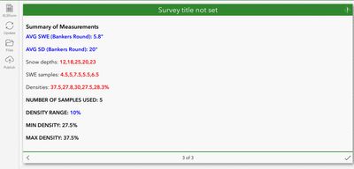

There is a way to do this using java script functions. Read in what you want to display using a calc field:
pulldata("@javascript","displayrho.js","samples", ${RHO})
Simply make the function return the string:
function samples(RHO)
//dsiplay all samples
return RHO;
Then make a note field using ${DisplayRHO} . This will list them with comma's in between. Let me know if you find a way to get this in table format!

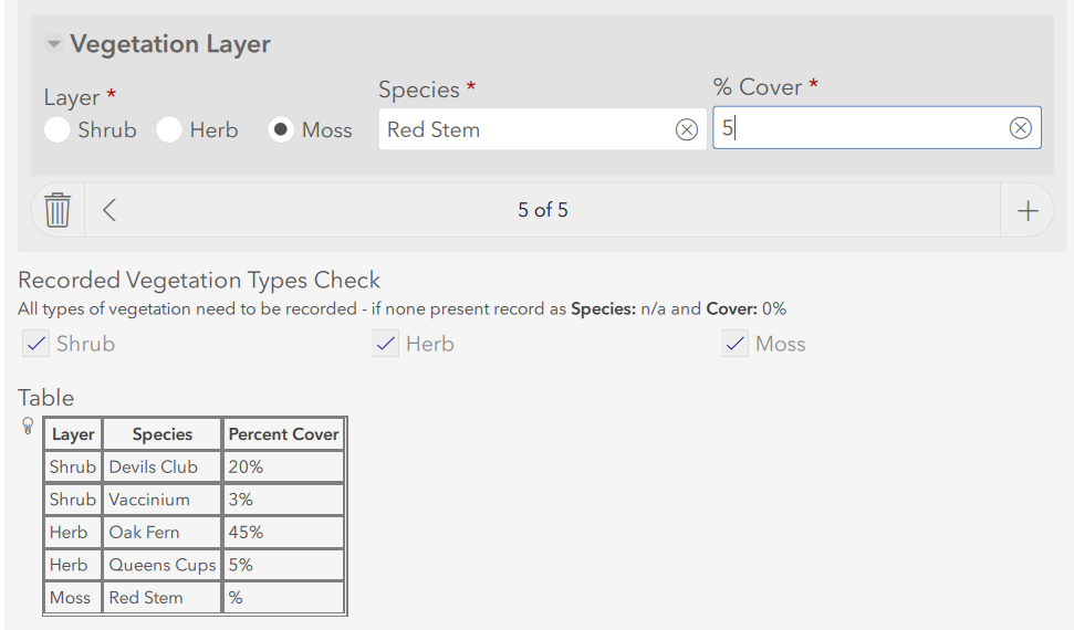

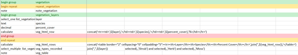

I came up with a hack for this. I used an HTML table to display the entire contents of the repeat. Unfortunately CSS is not supported so I had to revert to deprecated table attributes:
  1. For each repeat I created a calculate that created a table row by concatenating each field surrounded by tr and td tags- in my case named veg_html_row
  2. I then concatenated all the rows inside some table and table header tags using another calculate outside of the repeat - see veg_html_rows
  3. I then put the results in a note field
