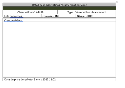

CarolinaMatoszko
We have adptaded and re-adapted our report several times but we still are having issues with our report.
We can see the squares for the photos but they are empty. It seems like we cannot "get" any data from the photos...
Regards
Carolina
(ESRI France)
ZhifangWang
Hi @CarolinaMatoszko ,
We received the case #03004740 raised to Esri Support Service, I got the report template (.docx file) but without the XLSForm file yet. Can you please share both the XLSForm file (.xlsx) and the report template (.docx) with me (zwang[at]esri.com)? I will reply to you in email.
