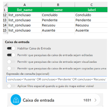

Survey123: 1,031 records

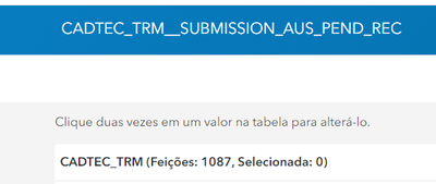

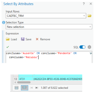

ArcGIS Online/Pro: 1,087 records
I've already tried some SQL combinations and they all return the same difference in values. Some of the tests carried out:

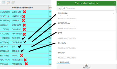

I noticed that many of my most recently edited records do not appear in the Inbox in Survey123:

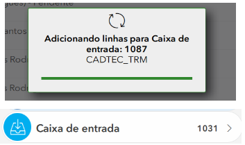

I also noticed that when updating the inbox, the correct value (1,087) is displayed in the popup, but at the end of the process, only 1,031 are displayed:
When you break down the query (e.g.: conclusao='Pendente'), the number of records returned by Survey123 is correct. However, when I combine two or more queries, the difference happens.

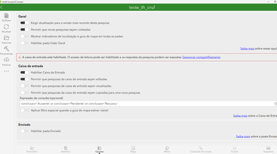

I even created a new test form (with a much simpler structure than the original), pointing to the same layer, and the error persists. The form settings follow:

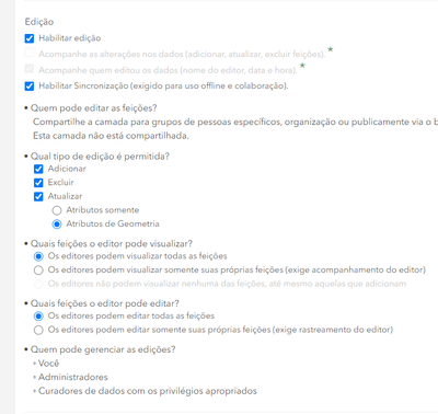

If you go into the Feature layer REST services, what is the Max Record Count set to? This could be the issue, I think the default setting on Survey123 created feature layers is 1000, and you have more records than that? Though I notice that the Inbox already shows more than that, so that makes my idea seem less likely..
Yes, the limit is 1,000 and I have more records than that.
I also don't think this is the problem, because currently Inbox is returning 1032 records and in testing with other layers I can return more than 4700 records (even with maxrecordcount=1000). As far as I know, the Inbox limit is 5000 and the layer's maxrecordcount doesn't interfere with that (please let me know if I'm wrong).
Anyway, I contacted Portal Enterprise technical support, they also noticed this difference in the data. It is currently supported by ESRI for you to check. I will update the situation when I have more answers. Thanks.
