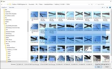

We are using Portal and not AGOL. I have numerous surveys that have an image question with a multiline appearance. Users are on the web flavor of Survey123 - they need to be able to attach up to several 10's of photos to a survey. These are photos sitting on a file folder. Therefore, to make things easier for the user, he/she will select numerous photo from the pick images dialog. This has worked well - see attached photo
Now, and all of a sudden, this functionality is not working in Survey123 web - the pick image dialog only allows users to select one - and only one - photo.
