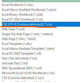

SpatialCadet
Id suggest checking that you are saving the the CSV format is UTF-8
RichardOHearn
I'm sorry, but I don't quite understand what you're saying here...when am I exporting something?
