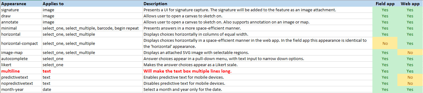

Hi All,
Looking the new form in Survey123 Connect and it looks good! Just had a question about the MULTILINE appearance and the IMAGE question. On the APPEARANCES tab, the MULTILINE appearance is only shown for the TEXT question. Can this be updated for the IMAGE question? And does this apply to the Web app? I have used it in a Web form (from Survey123 Connect) embedded in a Dashboard and I can add multiple images, though when I submit the form there are no attachments. I guess I need to understand if its not working as its not fully supported in the web form yet or its another issue I am facing. Thanks.

Hi Jamie
Thanks for flagging the issue with the template. As of 3.10 the multiline appearance is fully supported in the field app and web app, for both image and file questions. I've updated the Appearances tab in the Advanced and Standard templates accordingly.

Using ArcGIS Online. I am adding new data with the survey rather than editing existing data. The survey is built from an exiting hosted feature using Survey123 Connect. The Image question appearance is set to Multiline and method=browse.
Now knowing it's supported, I spent some more time looking at the data and trying to work out what was happening - and its working now. I had a field called 'Images' that was meant for a URL for existing data - with new data having the images actually attached. At some stage I had a less constructive moment and forgot about my original intention, and repurposed this as an Image question! When I saw the 'Images' attribute in the table just now I knew I did something wrong! Interestingly the image question (which was really a text field) was actually capturing the filenames of the images I was trying to upload and writing them to the text field (see image below). So even though it looked like I was adding images, I was not.
I added a new Image question with the same parameters and republished the form. This has resolved my issue. Thanks for your help.
