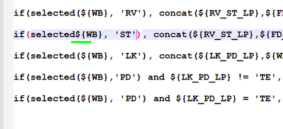

At a quick glance, I noticed in your expression that you're missing a parentheses here:
Does adding that fix the statement?

EMMA_UM
Good catch! Unfortunately, that did not solve the issue.

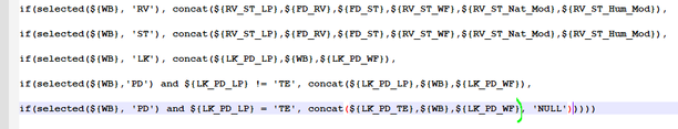

Sorry, I didn't notice this the first time....I think you need a parentheses here too? Because the 'NULL' is the final ELSE statement. (I highly recommend writing these statements in an editor like this with syntax highlighting! It always helps me with the grouping.)
If this still doesn't work I'll try to help more, but...let's try to get the simple stuff out of the way first 🙂

EMMA_UM
It's working! Thanks for your help. Do you have a go-to editor to check syntax (outside of this platform)?

For writing quick statements like this, I usually use Notepad++. You don't have to save the document as a certain file type for the parentheses highlighting to display (like you can see in the screenshot, where the matching ones appear in red.)
