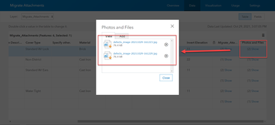

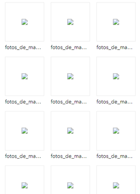

Any ideas? Just had someone run a survey today in the field and all of the images came back blank. I tried manually downloading each (gave me a 10x10 pixel white box). I tried running a report (error). Screenshot of what I'm seeing in the Survey123 online panel:

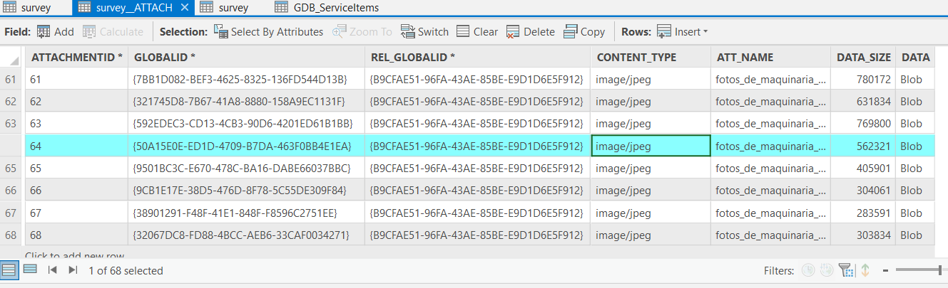

I also tried exporting the record into a GDB and opening that in Pro. Look at this attribute table: there are 68 images here, I just don't know how to open them! It would be very expensive to send someone back to get this data... any ideas on how I could access the images via Windows Explorer or other?

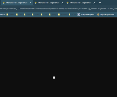

If you navigate to your data in your ArcGIS organization, on the data tab you will be able to view attachments, do you see the attachments in that location:
If you select the link for the image does the image display in the web browser?

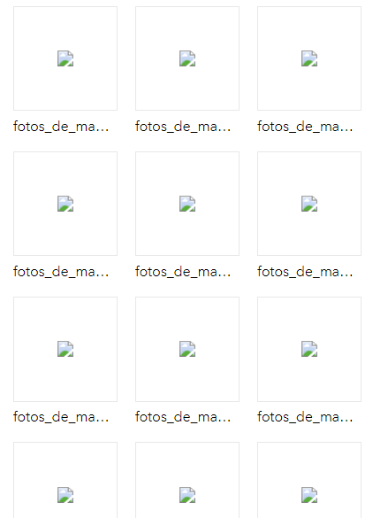

I got a similar result. When I click on any of the 48 attachments listed in the data tab, I get a roughly 10x10 pixel white square as shown in my screenshot:
There are images varying from 300kb to 900kb in size that all render this way. Something does seem off that the sizes are so small. I'm guessing this is error on the phone itself that captured the data?

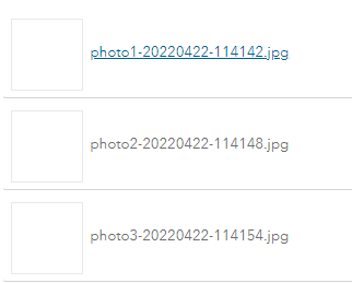

Did you get anywhere resolving the specific hardware issue here? I've got the same problem coming from one specific user who had previously been able to submit image attachments on the survey ok. For the last few months all their images have been coming though as white/blank with a resolution of 360x634 and a file size of 4.3kb.
