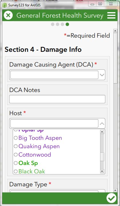

So...I thought I had discovered an new way to help my users by using html formatting to color code my list for select one questions:
list_namenamelabel
hostPoplarSp<font color='#6c09ac'><b>Poplar Sp</b><font>
hostBigToothAspen<font color='#6c09ac'>Big Tooth Aspen<font>
hostQuakingAspen<font color='#6c09ac'>Quaking Aspen<font>
hostCottonwood<font color='#6c09ac'>Cottonwood<font>
hostOakSp<font color='#24a507'><b>Oak Sp</b><font>
hostBlackOak<font color='#24a507'>Black Oak<font>
The results look great in the list, helping to visually break choices into groups.

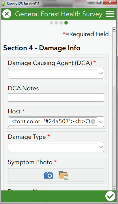

Unfortunately once a selection is made the choice is displayed with the html formatting.
I know I am probably pushing the limits of the intent of using html formatting in Survey123 but was wondering if there is any solution to having the formatting text show up in the selection?

Hi Brent. Using HTML formatting in your labels is fair game. It should work well. Turns out HTML formatting is not supported in auto-complete questions.  I added this to our backlog  so this can be looked at in the future. In the meantime, given that your choice list is small, I suggest you either use the minimal or default appearances.

Thanks Ismael,  I didn't think to try a different list appearance. Minimal did the trick.

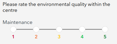

Is the same still true of the Likert appearance? I have a list as per below that I use to present a Likert scale choice on a form.
list_quality1<font color="#C70039"><b>1</b></font>
list_quality2<font color="#F07339"><b>2</b></font>
list_quality3<font color="#FFC300"><b>3</b></font>
list_quality4<font color="#15C14E"><b>4</b></font>
list_quality5<font color="#04782B"><b>5</b></font>
The form appears as below:
The underlying table captures the choices as below:
I can't use the 'minimal' appearance to get round the issue as suggested because I need the Likert scale format.
Any further ideas on how to get round this html issue and collect only the number (1,2,3,4,5) that represents the choice made?
