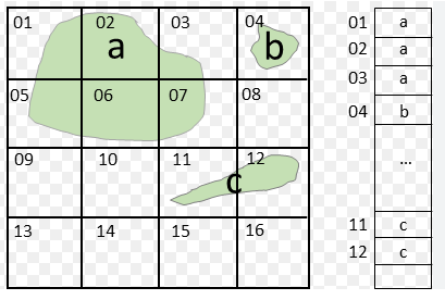

Spatial index can grind you to a halt for sure.  Last job I had to automate checking extents in our SDE since it would cause so many issues and people kept adding 0,0 all the time (cause spatial in NOT important lol).
I cannot find great graphics but I will try.
Arc takes your data extent and chops it up into a checkerboard like this (kinda).
It does this so it can draw just one of these boxes at a time.  So if you are zoomed into a above it just draws box 02.  This is very efficient - why draw box 15 when it is not even on the screen.
What happens when you have 0,0 points and work in North America is now ALL your data is jammed into one single box.  This means that even when zoomed in Arc has to draw the entire dataset!  So basically it is unindexed at that point.  You are drawing every single point or vertex every single zoom or pan.  Gets real slow real fast and I think it is most of users performance issues when in Esri land.  I have brought many old datasets back to life just fixing this while consulting.
I hope that made sense.  For sure 0,0 points are a killer.  I look for and fix them then recalc extent, then recalc the spatial index.  There are ways to do this in SDE and AGOL.
