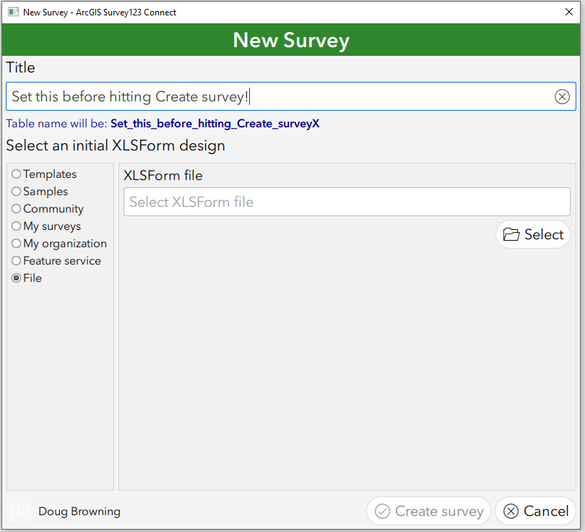

I have found once you get it wrong the first time forget it and start over.  There may be a way just not worth it.
The trick is to create a new survey from file then make sure to set the name right away before hitting create.
Then copy over any media files manually.  Works for me.

Thank for your response.  I have read one similar suggestion from one Esri person on starting a new form from existing Form Excel to get all names right.  I may have to go this route if I cannot find other solution.
