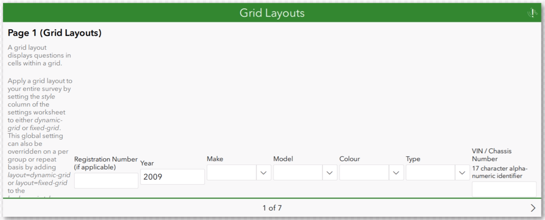

I even opened the sample Grid Layouts survey, and when I look at the preview in Survey123 Connect it looks extremely "wonky".
This is what the preview looks like.

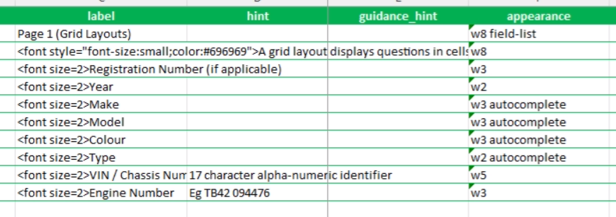

This is the XLS form it's based on, provided by Esri.

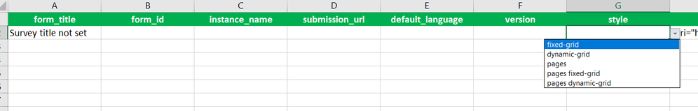

May be you are running an old version of Connect? This is what I see:
Also, if working with old forms, please check the style values in the XLSForm settings spreadsheet.  Theme-grid is supported for backwards compatibility, but it is recommended to use either the fixed-grid or dynamic-grid styles.

Thanks Ismael. I updated my version of Connect to the latest version (3.14) and the grids appear to be working. Not sure why it would have stopped working in a previous version though, because it used to work...
I admit I was a bit "scared" to upgrade, as I've heard about so many issues after upgrading to 3.14. But, fingers crossed things will be fine since it's been a while now since the new version release.
