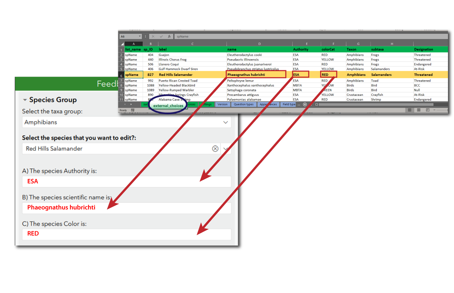

Hello Everyone,
I want to use external select  to capture information from a large list (2,000) containing species name and other attributes. My question is... How could I pull the values from the external_choice sheet(tab) to populate a note or a text fields in my form using cascade select?  I was able to get the  species name using the choice_filter but I am confuse on how it works. I could not found any examples of how to use external select to pull data or populate other fields. Here is a pic of what I am trying to accomplish and a sample of my XLSForm. The form will be used on Web App only. Thanks for any help or suggestions!spForm_Pic.png

Check out the bible page it has all you need.  https://doc.arcgis.com/en/survey123/desktop/create-surveys/xlsformformulas.htm
For your form the example for Authority would be.  Note external choice just creates a csv called itemsets in the media folder but you can now have this as an csv in the media folder and use select_one_from_file instead BUT not sure that works in the web yet.
pulldata('itemsets', 'Authority', 'name', ${sp_namexxx})

Hi Doug,
Thanks for your suggestions. I did try the pulldata function as you suggested but it did not work for me.  Unfortunately, the "bible" page does not have anything on external select or using external_choices sheet ( not a csv list).
